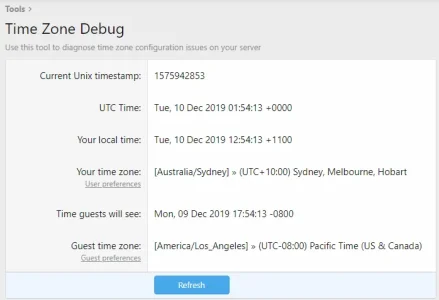

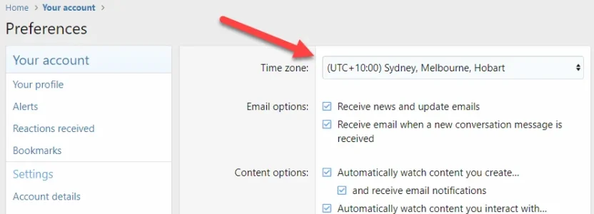

The XenForo admin UI shows times based on the timezone set in your profile as an administrator, including cron next run times.
If you're seeing the wrong time in the admin UI, either you don't have your personal timezone set correctly, or there is a configuration problem on the server.
For example: https://xenforo.com/community/account/preferences
