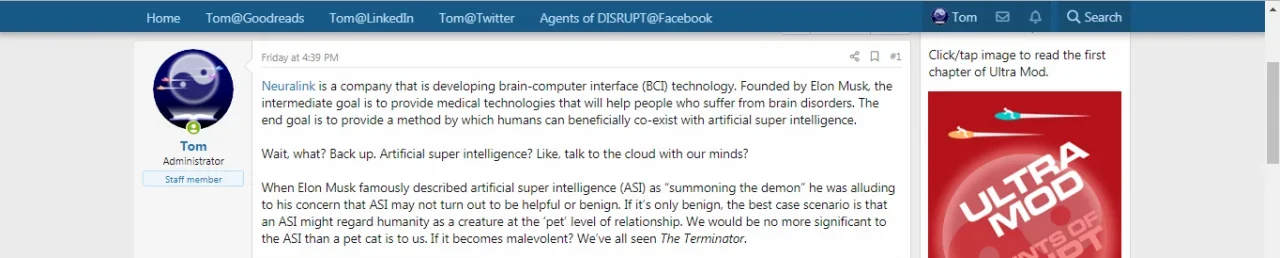

When I open a thread (or link to it) it looks like this:
204671
The thread title is not shown, so a reader has to scroll up to see it, as indicated by the vertical scroll bar.

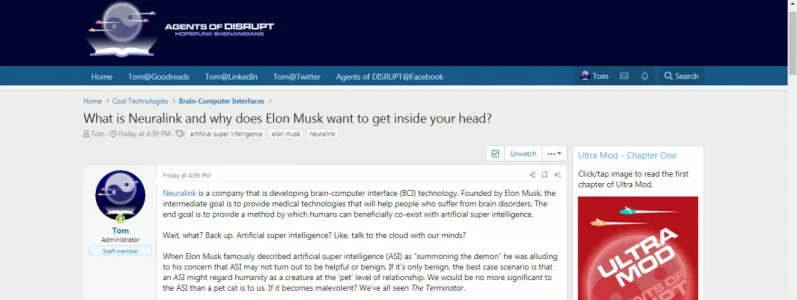

What I want is this:
204672
Much of the humor in my posts will be in the thread title. How can I change the behavior of the program so it opens a thread with all the header stuff showing? Or, at the least, with the thread title showing?

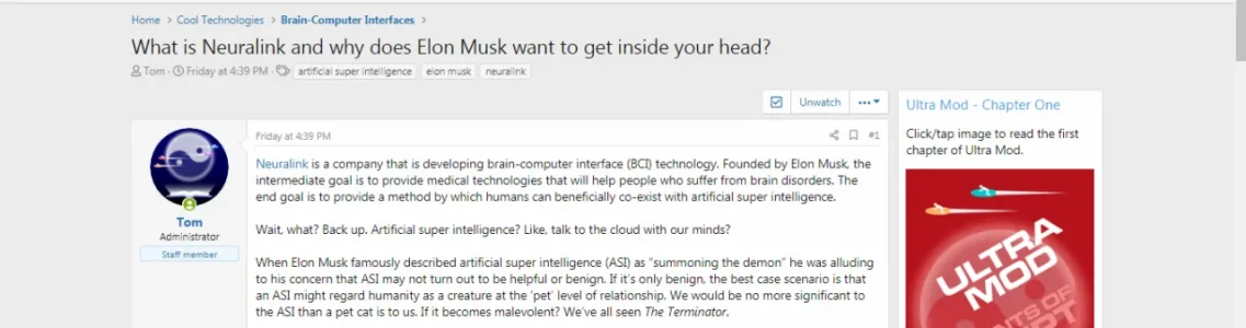

This would be good too:
204673

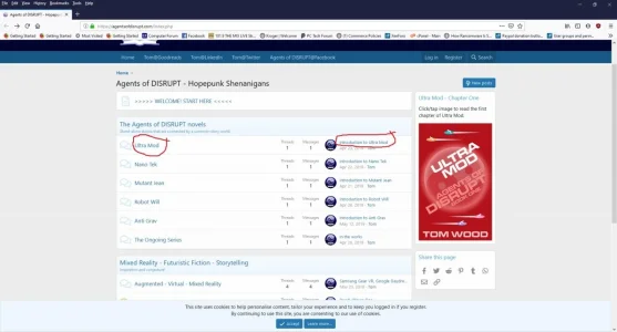

Ok this is weird. If you click on the section and then the thread, you'll see it correctly. But if you just click on the thread on the right, you don't see the thread title.
So click ultra mod and then click on the thread in there and it will display correctly. But if you just click on introductory to ultra mod on the right you have to scroll up to see thread title. Try it yourself.
