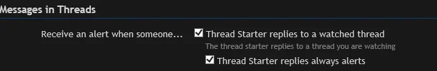

Another question :
What is the difference on alert preferences between these checkboxes :
  • Thread Starter replies to watched thread, and
  • Thread Starter replies always alerts
Thank you :)
"Thread Starter replies to watched thread" allows users to enable/disable thread starter alerts.
"Thread Starter replies always alerts" bypasses how XenForo will only send 1 alert for a thread until you revisit. It ensures users always are alerts if a thread starter alert occurs.
