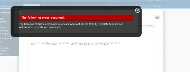

I Found the problem ::
The template was :
PHP:
<xen: if is="{$myname} == 1"><a herf="www.google.com">Google</a></if>
And there were alot of xen template syntax err ...
After Make them right :
PHP:
<xen:if is="{$myname} == 1"><a herf="www.google.com">Google</a></xen:if>
the msg should give a correct hint ? right ?

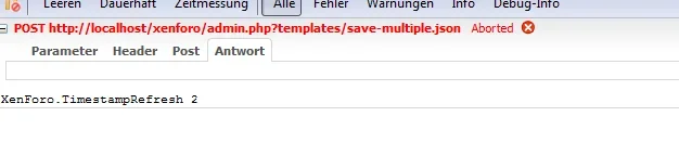

Hm, i can confirm this!
Instead of getting a error message,
it's running 2 minutes(my timeout time) and then i'm getting the timeout
It's because of <xen :if
