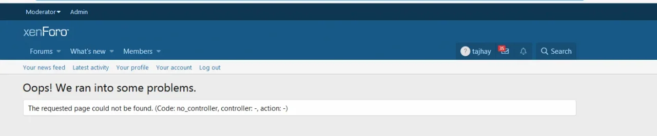

Fixed The requested page could not be found. (Code: no_controller, controller: -, action: -)

Today when i went to my site, it gave the above error. I have disabled all addons. Still get the above error.

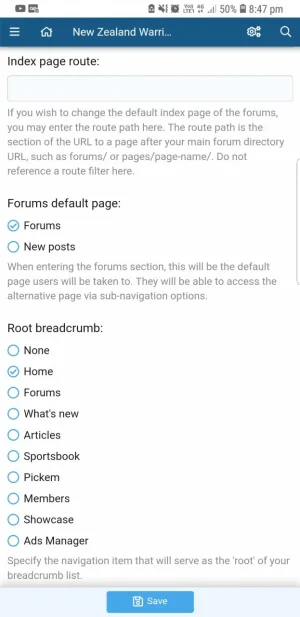

What value do you both have set for the indexRoute option under "Basic board information"?
And do you have a route filter configured for the route referenced there?
That would likely be the problem then. Any idea how it would have been made blank?

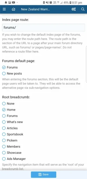

The default value for that option is forums/
No idea. I have not touched that setting at all. Maybe the portal add-on you guys created to help people learn xf development changed it when I installed it last night?
Was working fine and no options were updated yday beside updating to beta 4 and installing that portal add-on.
