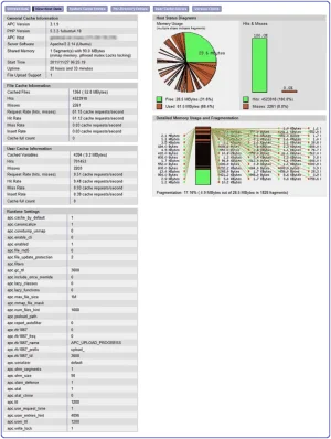

like many others i am sure, apc is working, it just needs a bit of tuning.
look at this pic and what does it say to you?

That your host has only been up for 20 hours ? ;)
I don't know, I haven't looked at server stats like this before, will try tonight
You have 9.2 MBytes of cached variables (+~52Mbytes for cached files, this totals 61ish), and a total of 61.5 MBytes of Memory usage (that's good isn't it?)
What does the hits and misses represent?
the way i understand it, hits are requests for things that have been cached, while misses are requests for things that have not been cached.
1200 is quite short .. I'd certainly consider raising the value
i will be the first to admit that i am not super knowledgeable with caching. i used to have it set to 7200, but lowered it to 1200 to hopefully combat fragmentation. google research came up with that advise. im not certain how it holds up in the real world.
after taking that screendump i restarted and 2.75 hours later i am already up to 4% fragmentation.

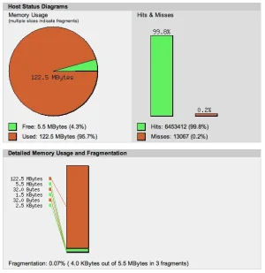

$config['cache']['cacheSessions'] = true; // from 1.1 beta 4 onwards
