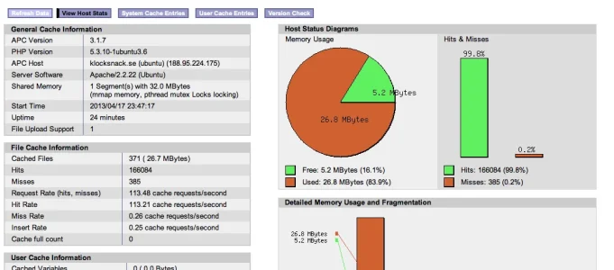

I can access the test apc.php that I uploaded, and I see this:
Short question ...is my APC working?

No data yet though...
There's 80 members active right now, so it should generate something if it'd worked, right?
Yeah, it would work instantly.

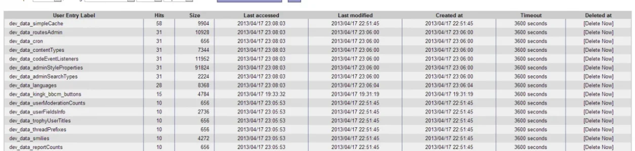

Here is from my dev site with only me on there

So... I should just be happy about caching the stuff I'm caching now?
It will be caching the compiled PHP scripts by default, which is where most of the speed improvement will come from.
