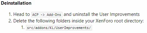

That would be because uninstalling KL's addon doesn't remove the database entries for it. It's an oversight on his part.
You hit the nail on the head - we shouldn't have to fumble through and possibly break things.
I don't make add-ons for Xenforo or do any DB stuff (obviously) but if I did it would seem like a programming 101 practice to name my DB entries with something that would not possibly conflict with others. So as an example: @Jaxel would name his DB entry discord_8WR while @katsulynx could name his discord_KL so at a bare minimum these kinds of things could not happen.
@katsulynx FYI - apparently uninstall misses DB entries:

had the exact same issue when i installed this addon when i had discord integration, try this https://xenforo.com/community/threads/xf2-8wr-discord-integration-paid.140836/page-7 third post if you have discord integration if not try removing the connected_account.php but back it up first just in case and try again.

Changelog
Bugfixes & Changes
- Fixed an undefined index error that would pop up if users would not have previously changed their names.
- Resolved an issue that would leave some traces of this add-on in your connected account provider database table upon uninstallation.
- Resolved a potential source of incompatibility with other add-ons that add connected account providers by prefixing...
