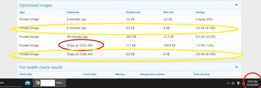

I'm seeing weird logs lately. My server time is in the same timezone as me (the data center is as well) and i checked that it's in line.
So, the red log actually happened in the future.
and the yellow log seems to be the exact same image - why was it optimized twice? is that a race-condition where 2 folks hit it at once and it's not yet optimized? but, if that was true, the time stamps would be the same.
anyone else seeing stuff like this?
The images are all working fine so its a low concern.
Just to check, I'll add this to my list to check and if it is a bug I'll get it reported on our issue tracker. Thanks for the report!
