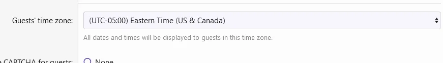

Maybe by default, the add on could set it to run by the forum time variable, instead of GMT/ZULU.
(This one: adcp -> options -> basic options -> Guest's time zone)
By default, it runs every hour. (but changes based on UK time, so it would start them at 7pm the night before, and turn them off at 7pm on the night of the holiday)
Thx again

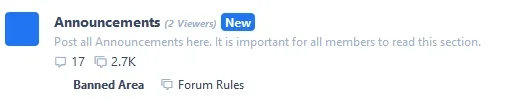

@mattrogowski Any update about not compatible with TH UI.X Pro themes? Also The Holidays addon changes the CSS of the node icons.
I'm not sure I really understand the problem - it should replace the forum icon with the holiday icon, and should work the same across all styles.

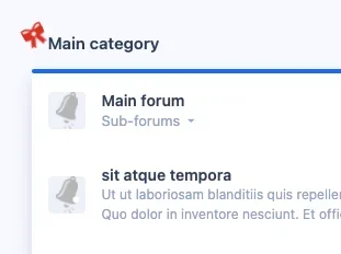

When I enable the Winter holiday I see this:
Looks like you're missing the bell icon image?
