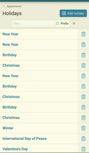

Seems holiday that are customized are now duplicated after upgrade :(.

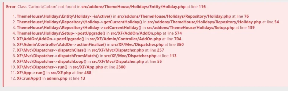

I am also getting error log with this version and all Holidays are created 4 times.
Error: Class 'Carbon\Carbon' not found src/addons/ThemeHouse/Holidays/Entity/Holiday.php:116
Generated by: Nirjonmela Dec 16, 2020 at 12:07 AM
Stack trace
Stack trace

Both have been reported and will be fixed in our next patch.
Reading the problems you had, I first proceeded to uninstall the previous version from ACP (plus delete files from src/addon/ThemeHouse/Holidays) and clean install the new one. Everything went fine without mistakes. I'm just mentioning it to help someone.
I'm getting Error: Class 'Carbon\Carbon' not found in src/addons/ThemeHouse/Holidays/Entity/Holiday.php at line 116 as well.
Yes exactly.
1st remove
2nd new install
3rd add own holidays
You won't get any mistakes like that.
It was reported and will be fixed in our next patch :)

Bug again :(
I'm not able to replicate these in the latest version I'm afraid. I'd suggest that you reinstall the add-on and see if this pops up again.
