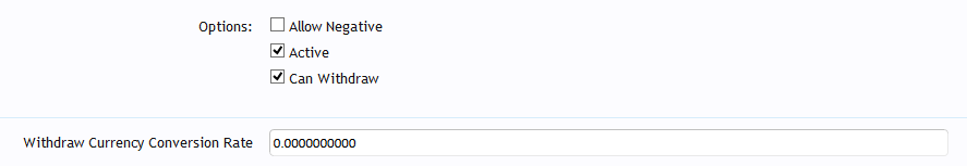

2) I want only one currency withdrawable and the other not. I tried to turn off "Can Withdraw" through the Currency page in admincp:
However, the currency still shows up in the Withdraw template and refreshing the admincp page shows that the option has been checked again.
I'm assuming this is undesired behavior. I also didn't notice a can_withdraw flag in the MySQL table, so I'm not sure how the setting is retained.
Edit x3:
Fixed* #2 above by replacing the following line in template adcredit_withdraw
          <xen:if is="{$currency.withdraw_conversion_rate}">
with
          <xen:if is="{$currency.withdraw_conversion_rate} > 0">
* While this fixes the front-end I fear that the back-end will still allow a withdrawal to be made on a currency that has withdrawal disabled (or conversion_rate == 0).
