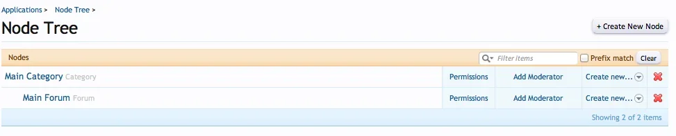

Before import - should I delete the main category and forum that is automatically created upon install of Xenforo?
The benefit is more or less up to you. It makes redirects easier if you keep them, but if you don't care about a slightly 'more difficult' redirects, I see no benefit for keeping them.
