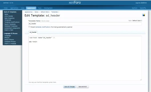

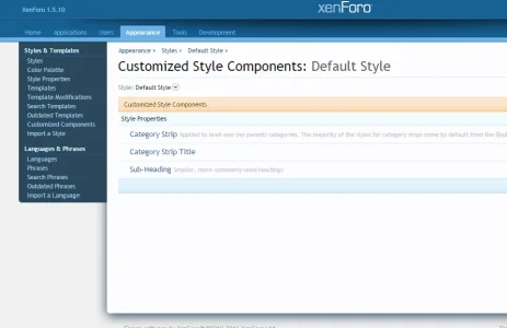

I am not sure what I am doing wrong. I am trying to make a XF add-on to remove all my manual template and style edits, but then I realized the the template modifications (that I made manually) are not listed in customized components section. But all the manual style modification is listed. Is it because I have enabled developer mode?
I definitely made changes in templates, example below. Also, where is the "revert template" button?
Ensure you haven't edited the master style by mistake.
You have dev mode enabled so that is a mistake people commonly make.
Oh, I guess I had done that. Now I changed again in default template, and it does appear now.
I had no idea what I was doing, being in the starting phase of my XF development. Thanks a lot.
