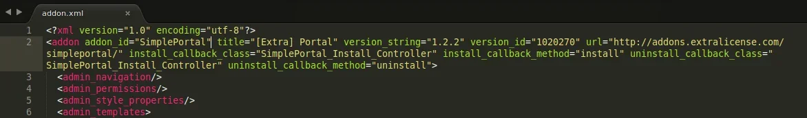

Most likely this is caused by a line break in the XML file done automatically by the editor software. You may want to check that.

I never knew that it wasn't already constrained to those characters, but it was. Seems like Extra Portal has modification keys such as:
add simpleportal promotelink
It tends to be the description copy and pasted, it seems.
The modification key always had this restrictions in its description. It seems like a bug fix, because this should always have been checked.
Anyway: This problem is caused by Extra Portal and has to be fixed by its developer.
