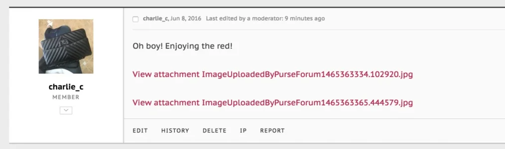

Concrete example:

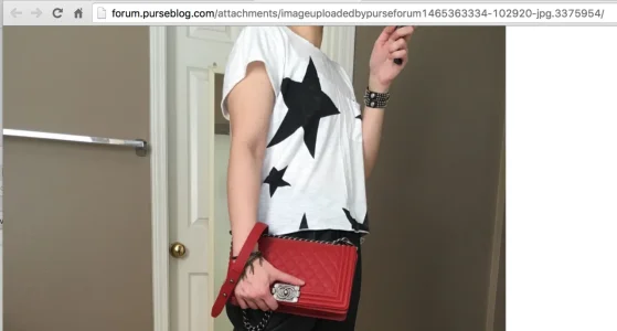

Clicking leads to:

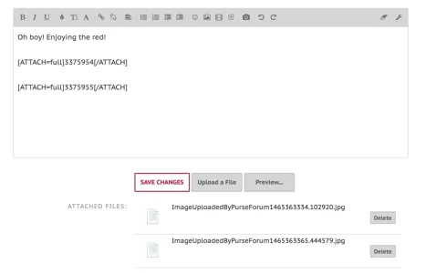

The post edit reveals:
The advanced editor reveals that the attachments appear to be associated with the post.
From looking at other attachments, the tag appears correct, so does the attachment ID. What am I missing? Thanks much.
This is down to the image not having a thumbnail. We use this as a proxy of knowing whether it's a valid image, but it can fail in the case of an attachment being too large to thumb.
Is this a large attachment, in terms of pixel dimensions? Out of the box, XenForo won't generate a thumbnail for images over ~20 megapixels.
Thanks Mike!
The images that are attached by our Tapatalk BYO app are max 2MP in size, the app already resizes the images. Perhaps I can try and run a thumb rebuild on all images, perhaps that failed during import (we have nearly 1TB of attachments). Going to look into how to get that done.
