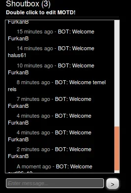

hi i'm not sure is it been asked before but got this problem on my friends forum its keep posting user activitys how can i stop it pls
