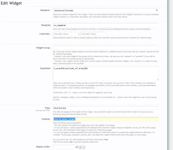

I have an Expression set to $forum['node_id'] == 38 as I want the chat to show up on forum 38, but it is currently also showing up on the thread pages under this node id. How can I have it show on node id 38 only and not on the threads themselves?
I have also tried in_array($forum['node_id'], array(38)) but the ad is still showing up on the threads listed under 38..
I read the first page, and have been at this for hours... I usually don't log into forums or ask for help.. But, can't figure this one out.
Also I am using hook:ad_above_content if that matters..
I have added <xen:hook name="dark_taigachat_alt" /> to the right area, but nothing appears?
Can you access the full shoutbox page at /taigachat? Have you set up the permissions?
Using Taigachat with [bd] Widget Framework
Add && $threads to the end of the expression

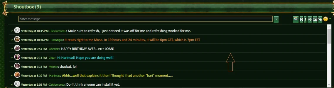

I'm occasionally having trouble seeing updates for the chat. Sometimes when I or others post messages they don't show until we refresh or post another message. Is there anyway to fix this? I already have speed mode enabled.
I'm running 1.2 and trying to figure out how to remove this line breaks and decrease the padding in between the messages and bring them a little closer together. Thanks in advance
That will typically happen if your server is misconfigured and is caching the speed mode messages.html files. Particularly this will happen if you are using nginx with the open_file_cache setting, which needs to be selectively disabled on /data/taigachat
You can test if this is the problem by disabling speed mode and the issue should go away
This would be particular to your custom theme, can you link me to your site and provide a test account if the shoutbox is private?
Thank you for the response Luke ... that's correct, it is a custom designed and custom coded theme. I'll PM you access information. Thanks again.
