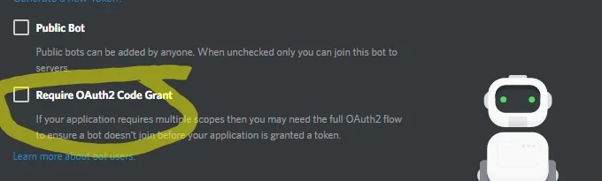

So I figured what i was doing wrong. I was checking "Require OAuth2 Code Grant"
Because I read this on the review:

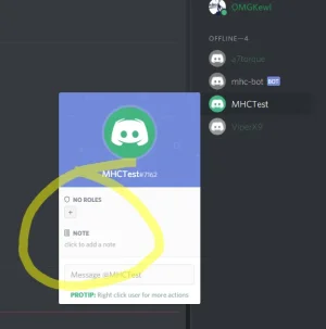

But I still cannot get the bot to automatically assign them the roles / permissions. I must be doing something wrong. I give the test account link to the general channel that has @everyone permisson but it doesn't get any roles assigned to the account even if its been linked through the site.

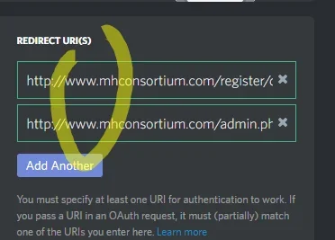

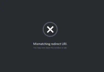

2. Is it normal to get the "Mismatching redirrect URL" if they unauthorized an account and try to reauthorize it?
By adding www. on the discord redirect url still works first time linking but if you unlink and try it again it gives you the error.

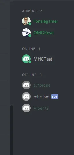

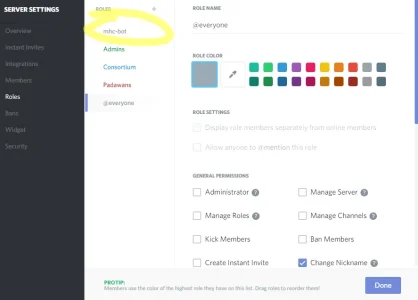

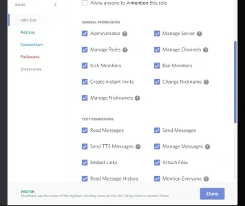

Here are a couple images of my bot setup.
upload_2016-8-29_22-27-6.webp upload_2016-8-29_22-27-42.webp upload_2016-8-29_22-28-22.webp upload_2016-8-29_22-29-47.webp

I have 20 roles on my list and was able to re-associate everything after the update. Maybe verify your bot's role is still at the top of the role list.
