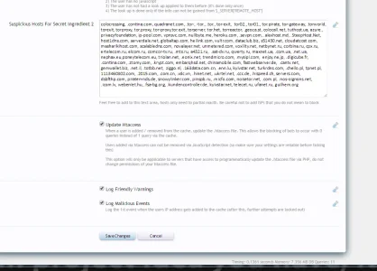

DEDOS
blocking hosts in the options:

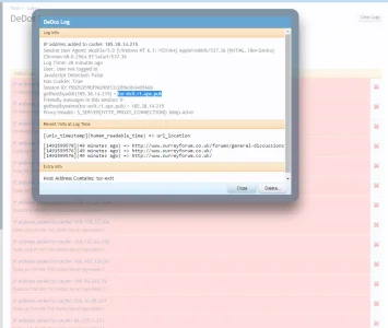

There are various methods that detect scrappers and report the hosts in your logs found:
admin.php?dedoslogs/
click on each one, and you will have information of why it was detected, in addition you will often be provided with the host (which you can add back into your settings to catch them quicker next time). But please bear in mind, not all ip's will be resolved as a host using gethostname
Example:
upload_2017-4-7_23-3-14-png.150900

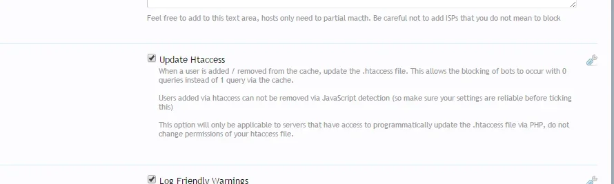

This is where you can turn on the htaccess option
admin.php?options/list/dedos
It is found under the options "Update Htaccess"
upload_2017-4-7_23-16-17-png.150902

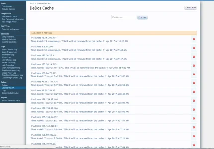

There is also a cache area, so even if you do not have an environment which allows automatic update of the htacess, the bots are added to a cache which significantly reduces queries and resources to due to bots, this can be found under
/admin.php?dedoscache/
upload_2017-4-7_23-21-20-png.150904
