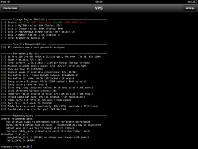

I've recently been running MySQL tuner, and it keeps reporting that my table cache hit rate is at 0%
It's only just started reporting this, as it used to report:
1K open / 14K opened after 20 days of uptime
It's now reporting a LOT more tables being opened, even after just 15 hours
Any recommendations on these settings?

What's your table_open_cache setting?
I would love to know what app that is you are using for the iPad? Thanks.
I changed a few things round yesterday and put a few variables back to how they were a few months back, and it's looking at lot better now

FYI mysqltuner values and recommendations are just based on a preconceived and not entirely accurate formula
i.e.
in relation to mysqltuner.pl original version, table cache hit rate recommendation is triggered when the ratio of tables open to tables opened is less <20:1
This ratio doesn't really mean much, as tables opened is incremented when you hit table_open_cache limit but also is increased with temp table creation. I suspect raising your max tmp/heap sizes from 32M to 64M did more good for this. Not going into a long explanation, but if you look at tuningprimer.sh it reports tables cached is fine.
Just remember tuningprimer.sh and mysqltuner.pl only report guidelines and you need to look at the actual numbers/stats themselves to determine if you're running optimally and not just rely on preconceived formulas and ratios ;)

Cause and solution might not be entirely the same - as I said above, depends on specific values for various status variables.
