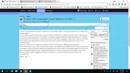

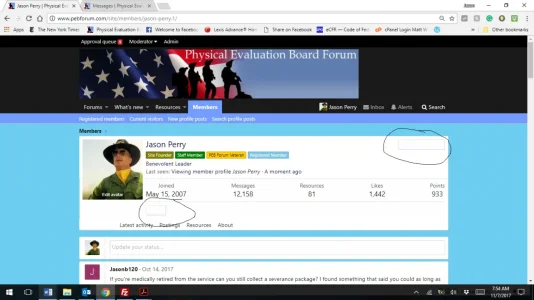

Anyone know how or where I can change the style elements to get these buttons to show up visibly?
I have tried all of the "button" properties, to no avail.
Thanks in advance!
Jason

I saw that on the "inspect" when I looked at in the browser....but, where do I find that?
Which style property or css file? I searched within ACP for all this (css and button.button--link ) but no results returned.

You don't need to find the css template, best things is to add that code to the style's extra.less template, which should then over-ride the default.

That worked great!!! Thanks....but.....
So, still having the same issue with this situation:

This should cover both sets of buttons
.button.button--link, a.button.button--link
And that worked a charm!! Thanks!
Solved my problem, so I really appreciate the help.

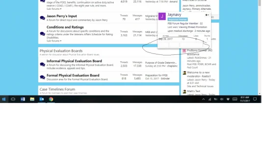

I keep coming across this same issue. Here is my latest in Resources Add on:

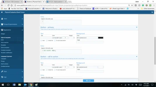

I agree this should not happen and fixing it like this, class by class is not the way to go. You need to find out the rot of the issue.
Somehow in some style property dark link text is now light.
When changing the basic color palette, you should always check that the colours you change to are similar kind of lightness/darkness - whatever the actual hue. (unless you are creating a dark theme in which extreme light becomes extremely dark and vice versa)
Your accent colors should be part of the main scheme of your style or close to it. Whether you wanted white buttons I’m not sure but I’m guessing not, adjusting the accent color would likely fix most of your issues as the default button link “color” uses a contrast function from the accent color.
