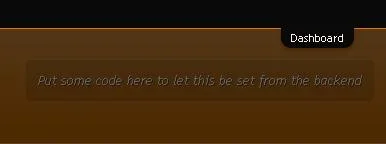

How's this mockup ?
As you can see I've made it look like xenForo, but I've eliminated all the things that would require Wordpress to query xenForo - as this idea is *JUST* visual integration.
Here are the removed items:

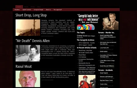

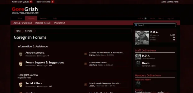

I made what I would call a seemless wordpress theme. Same width, positioning, header etc etc running with a fixed width custom xenforo theme I released here someplace. My site is not exactly user friendly content but hey we're talking cosmetics here.

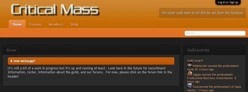

I'm about 90% done with my Wordpress/XF theme for my site. The beauty of it is once it's done it pulls all of the css and data from XF so really it should match about any theme with minimal work. I'm planning on releasing it once it's done.
Looking forward to it.
Update on Wordpress and Xenforo using the same CSS !
I'm not quite done with it, but it's close, but I've got a wordpress theme that pulls all the css from the xenforo installation. Hoping to be done with it soon but no set timeframe on it. http://www.criticalmassguild.com
That link goes to the wordpress home page, and it's running one of the flexile dark themes on the XF backend.​
Looks great already !
So on the Wordpress HomePage all the links for Login/Register are still Xenforo ?
What is the plan for the dashboard ? People would REALLY like if Alerts could be pulled to the Wordpress Home Page.

No specific plan for the dashboard yet actually, I may have it just revert to the header xenforo uses there for alerts etc. That's part of the piece I'm hung up on at the moment.
