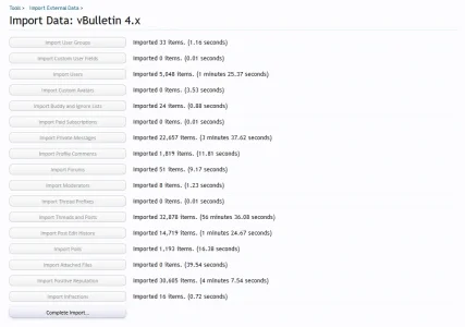

Well, what a difference it makes when your server is configured correctly lol
56 minutes, importing 733,000 posts. nice
