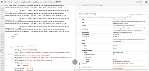

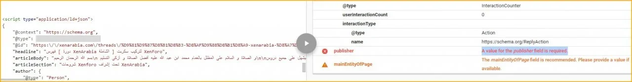

Xenforo 2.1 default DiscussionForumPosting markup gives Error on google structured data test tool.
So, it doesn't pass the test.
Errors are;
publisherA value for the publisher field is required.
mainEntityOfPageThe mainEntityOfPage field is recommended. Please provide a value if available.
Example URL Test Link

How can we put the Publisher (mandatory value) and mainEntityOfPage values to structured data vars.

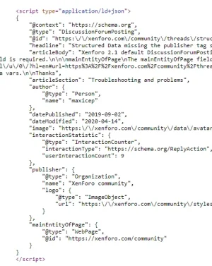

If you have this template edit in place, it's no longer needed with 2.1.6 - Oddly, shortly after this conversation somebody else reported it as a bug and the MainEntifyOfPage and Publisher tags are now included. https://xenforo.com/community/threads/structured-data-missing-in-discussionforumposting.170239/
One item of note.... the MainEntityOfPage type in 2.1.6 is 'WebPage' instead of the more specific 'DiscussionForumPosting' and the id points to the general XF home page and not the specific thread.
