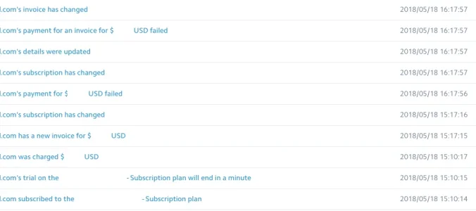

I've attached an image to illustrate the problem.
The timeline goes like this:
  • Customer creates subscription
  • Xenforo creates a "trial period" of 1 minute (I think)
  • The initial charge goes through before the trial ends
  • The first invoice for $0.00 as a trial is successful
  • But the next invoice is immediately generated for the subscription price
  • This invoice is not completed and paid because the payment was already processed
  • Stripe starts trying to re-create the payment every day or however it's set up, but the bank blocks it
So currently I have this customer (first on the new Stripe API through Xenforo and not the BDpaygate plugin) has an open invoice for the first month that's already been paid before the invoice is generated. It's been trying to re-ping that payment and failing and ultimately I think will cancel the subscription (I'm not there yet, probably tomorrow).
So either it's going to cancel the subscription after 3 fails at a 2nd "back-to-back payment" or it's going to ignore the first invoice and wait a month and charge successfully on the 2nd one.
This doesn't seem remotely ideal. I never set up a trial period or anything in the dashboard.
Can anyone give any insight into this? Is it a bug?

@Chris D, I switched to the correct webhook and got a new subscriber and the exact same thing happened. It generated a minute long trial and then opened the subscription which was already paid, and will now start trying to collect a 2nd payment.
The implications are that the subscriptions are no longer subscriptions since you have to kill the 2nd (legitimate) invoice that should be marked paid, but it's not marked paid because the free trial gets marked paid instead. So once you close that 2nd invoice that tries to recollect again, I think that ends the subscription. It also renders any other finance tracking useless because it doesn't recognize the payment as Monthly Recurring Revenue, but as a one-time payment.
Correction, it does look like you can cancel that invoice and Stripe keeps the "upcoming invoice" for the next pay period. However, this requires manual intervention for each customer and isn't ideal at all, and it still marks the first month as one-time cash flow and not recurring income.
Is anyone else seeing this behavior? Can the developers look into it and see why this is occuring?
