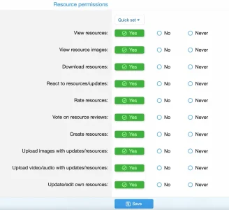

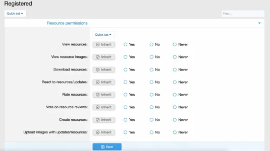

The general permissions for resources for the group "registered" is set to "yes":

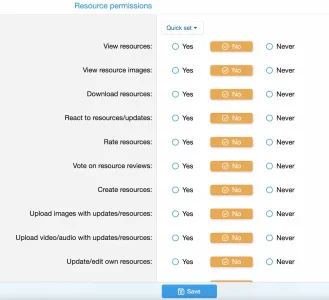

But when I pick a random user of the group "registered" and check his general permission for resources they are set to "no":
I've checked this for a sample of about 10 different users that have been registered between today and 1,5 years ago when I started the forum - all the same.
Question 1: How come that the general permission of the primary group a user is in are not applied to that user if he is not part of a secondary group that says differently?

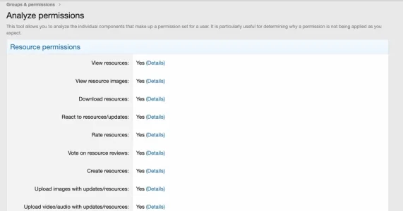

If I analyse permissions for a certain user for the resource category they are set to "yes" - as it should be. But why?

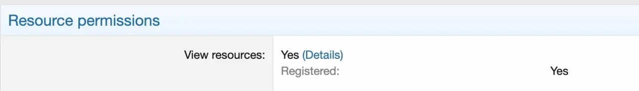

The details only refer to the group "registered", the only one the user is in:

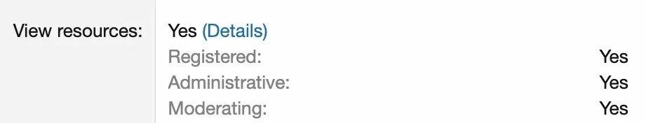

in comparison: if I do the same analysis for my own user all the user groups I am in are listed:
But then: Why does he (and all the others) have a "no" when analyzing the general resource permissions for the same user? Where does it come from?
Question 3: How can I find out what causes the individual setting of a certain permission for a certain user? I did certainly not manually edit 100s of users, so there must be a reason. But how do I find it?
