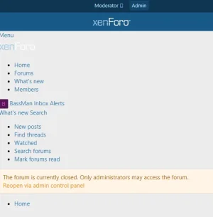

BassMan Well-known member Sep 6, 2017 #1 I just installed XF2 beta and it looks like this: Somethings not loading right. What could that be?
Chris D XenForo developer Staff member Sep 6, 2017 #2 Did you install via the CLI? Or do you have any sort of caching/compression stuff (such as CloudFlare) enabled? Did you previously have a dev preview build installed? Upvote 0 Downvote

BassMan Well-known member Sep 6, 2017 #3 Chris D said: Did you install via the CLI? Click to expand... No. Chris D said: Or do you have any sort of caching/compression stuff (such as CloudFlare) enabled? Click to expand... Yes. Chris D said: Did you previously have a dev preview build installed? Click to expand... No, it's a clean install. Upvote 0 Downvote

Mike XenForo developer Staff member Sep 6, 2017 #4 Can you provide the URL to this install? Upvote 0 Downvote
BassMan Well-known member Sep 6, 2017 #5 Mike said: Can you provide the URL to this install? Click to expand... PM sent. Upvote 0 Downvote
Mike XenForo developer Staff member Sep 6, 2017 #6 This is likely the same issue that was reported once before here: https://xf2demo.xenforo.com/threads/style-not-full-loaded.1641/ At a guess, the same cause too. Upvote 0 Downvote

BassMan Well-known member Sep 6, 2017 #7 Oh, wasn't aware of that. So i guess I need to disable CSS minify in CloudFlare. Upvote 0 Downvote
BassMan Well-known member Sep 6, 2017 #8 Confirmed, disabling CSS minify in CloudFlare sorted out the issue. Thank you. Upvote 0 Downvote
