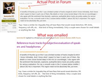

I tracked this down to user alias being corrupted even in the email it was trying to deliver!
Strangely, a different set of hex values were used for the actual email to comcast. The email was being sent to the person quoted above.

I am wondering if the hex values represent the alias and somehow they were used rather than the ASCII text.
The post/quote content has no bearing on the email addresses involved.

I understand that. But if that text field is corrupted in the same manner as the email alias, then it points to the problem being a bug in Xenforo and not elsewhere.
If I'm correct that is not the case. The actual mail to comcast is correct, but the spam report -you- are getting will have these kind of random values and you can only see @provider.com in real names, so in your case @comcast.net.
The cause here is that it seems they most likely are not allowed to send the full mail address to you probably due to privacy reasons.
