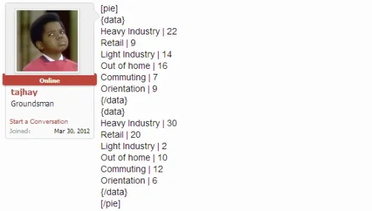

I have tried a linebar from your example and that worked fine, however the pie example
[pie]
{data}
   Heavy Industry | 22
   Retail | 9
   Light Industry | 14
   Out of home | 16
   Commuting  | 7
   Orientation | 9
{/data}
[/pie]
doesnt show anything now. Any ideas?
Btw funnily enough the help bbcodes menu shows the bbcode and the pie diagram, but when i post it on a thread it doesnt show.
This is such a fantastic addon! thanks so much!
@tajhay
If the Bb Code is not parsed, just be sure it is available in the Bbm Bb Codes manager and enabled. I still need to finish the FAQ and to fix a few things (point-labels had to be done by data serie, I've modified this on Github), then you can contact me by pm with your board url if you want (probably this weekend).

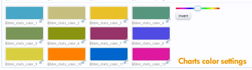

Hi Cedric,
Is it possible to list a set of defined colours to use first. If that set is exhausted and already used up, then do random colours(or however it is generated right now)?
Hi Cedric,
The script uses 12 colors (that you can customize). If your chart has more than 12 statistics elements, then it will reuse the colors (1,2,3...12, 1, 2, 3...).
settings_01-png.68982
Available in "Style Properties: Color Palette".
That is fantastic! Thank you so much!
