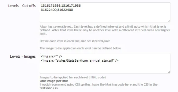

My register_date is 1316171936 so one year later is 1347794336 (difference between the 2 dates is 31622400)
How would I get a medal to display for each year of membership?
Yep. So in the 'Levels - Cut-offs' field I enter '31622400,31622400'

Something still not quite right. I've tried both methods above.
It sort of works but this is the code it adds to the page.
<div class="StatsBar_MedalBar StatsBar_MedalBar_member_view"><span></span></div>
<div class= "StatsBar_LevelBar StatsBar_LevelBar_member_view"><span><img src="" /></span></div>
So you get a blank one first, then it loads the one with no image.
So how do you get the image to load?
As you can see in the code above, the level with the icon_annual_star.gif doesn't appear on the page. It loads a div with a blank span in first.

Sorry made a mistake, every iterative level has to be that x value more than first level's cutoff, so it would read like this:
1316171936,1316171936
31622400,1347794336
