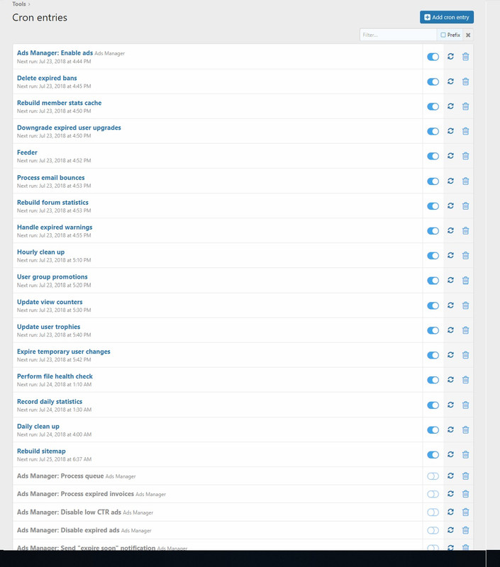

All crons seem to be stuck :confused:

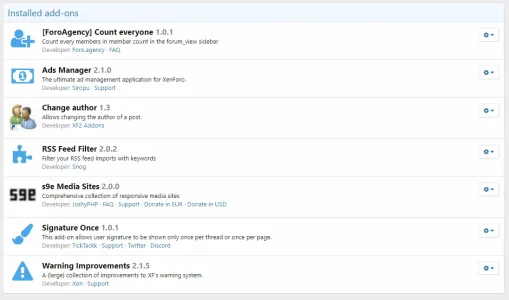

Thanks. Tried that, no luck unfortunately. We dont have many (they're below) and the ones we do, have been running long before Cron tasks stopped.
