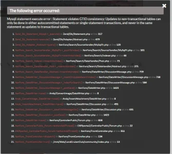

I recently reinstalled my QA server and put mysql57 on there (my prod has 5.6).
I am now getting the following error whenever I try create a thread or resource.
Mysqli statement execute error : Statement violates GTID consistency: Updates to non-transactional tables can only be done in either autocommitted statements or single-statement transactions, and never in the same statement as updates to transactional tables.
I've turned off GTID in the my.cnf and restarted mySQL but to no avail.
Any clues as to how to get this to work?
This DB is a restore from prod in both code and DB.
Full error:
Thanks
Crispin

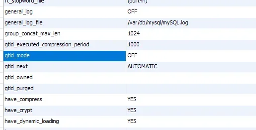

So that's the odd thing - they were on (by default apparently) and I turned them off.
I set them off with the @globalthingymagig as well as in the my.cnf. A reboot and it still shows as off.
Perfect! Thanks for the tip. Setting that off and/or editing the my.cnf and setting it to zero there works.

yup, same here. I get this every time I try to log out from the user side (admin side seems to work fine).
[LIST=1]
[*]Zend_Db_Statement_Mysqli->_execute() in Zend/Db/Statement.php at line 297
[*]Zend_Db_Statement->execute() in Zend/Db/Adapter/Abstract.php at line 479
[*]Zend_Db_Adapter_Abstract->query() in Zend/Db/Adapter/Abstract.php at line 661
[*]Zend_Db_Adapter_Abstract->delete() in XenForo/Model/Session.php at line 487
[*]XenForo_Model_Session->processLastActivityUpdateForLogOut() in XenForo/ControllerPublic/Logout.php at line 44
[*]XenForo_ControllerPublic_Logout->actionIndex() in XenForo/FrontController.php at line 351
[*]XenForo_FrontController->dispatch() in XenForo/FrontController.php at line 134
[*]XenForo_FrontController->run() in /index.php at line 13
[/LIST]
