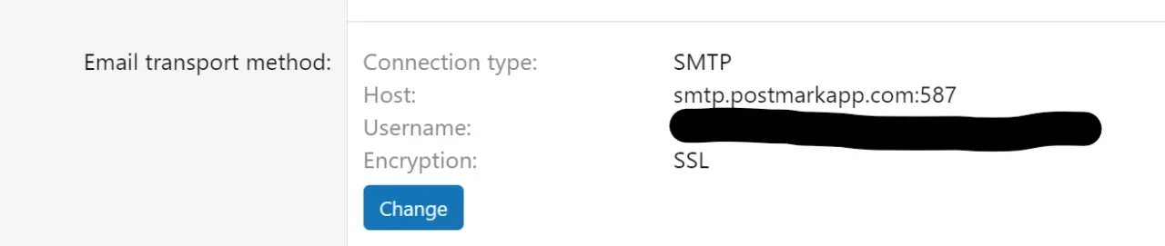

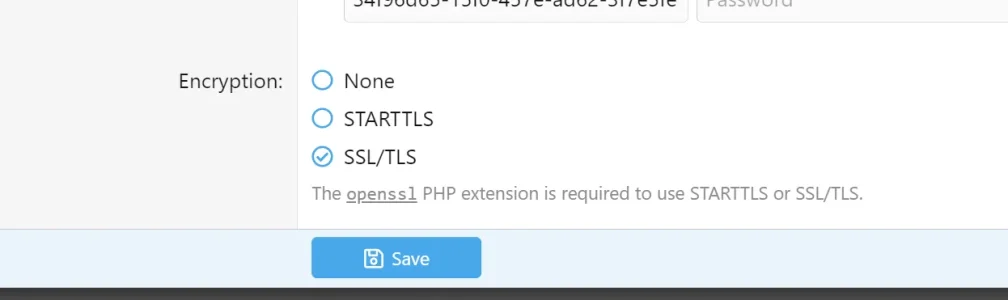

SSL is forced:

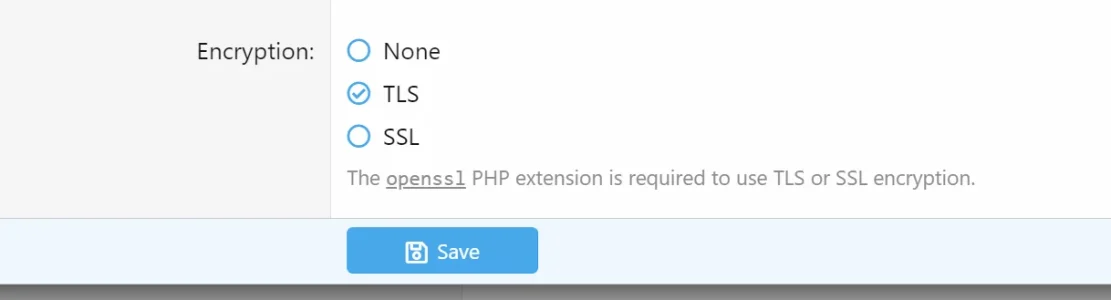

The encryption doesn't allow you to choose TLS:
Whereas XF 2.2.15 has the choice:

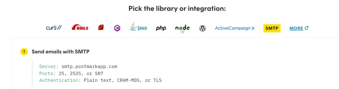

This causes services like PostMarkApp can't be used because TLS is the only available encryption:
The choices are the same, the terminology has been updated:

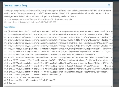

2.3.0 beta 8 returns this error:
The error can't be reproduced on XF 2.2.15 so there isn't a misconfiguration.
I see, I think there is an issue with TLS in 2.3, but it is not directly related to the renaming of the options.

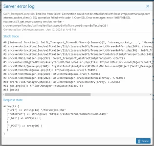

Well, I'm experiencing the same issue on XF 2.2.16 after updating from 2.2.14:
The same error can be reproduced no matter what port I connect to:
@Chris D
Was it working okay on 2.2.14?
This code didn't change between 2.2.14 and 2.2.16. So it's highly likely to be some other issue.
