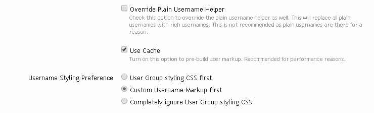

This overrides any default usergroup styles you have in place. I was hoping to still use the usergroup styles for specific users. And then turn this on for other groups.
Go into the Options for this and modify the settings so it does not override the default ones.

I use these options as attached.
