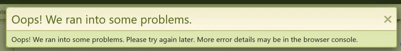

Some of my users report that when posting a long response (or taking a long time to type a response) they will sometimes get locked out of the site for an hour... after which they are allowed to return and everything runs as normal.
Looking into my server, I have ModSecurity enabled, and see a lot of "Rule 300016: Generic SQL injection protection" hits.

I wasn't able to replicate the issue until yesterday, and then it occurred when I was truly doing nothing more than responding to a post. I responded, and then went in and edited my post a couple of times, and then when I tried to repost I found myself locked out of my own site; the firewall had blocked my IP :)
