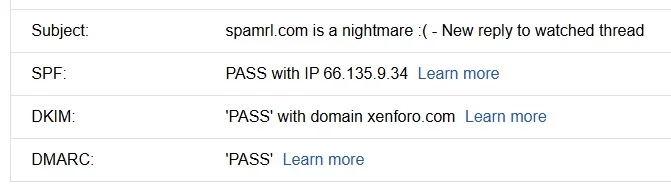

After setting up the DMARK + DKIM + SPF combination, all problems with sending mail disappeared. And in half a year, spammers stopped masking spam letters.

This is the result we should strive for.
DMARC Results
--- Connection parameters ---
Source IP address: 0.0.0.0
Hostname: n/a
Sender: return+8d8ca62e+ld-b1ccacd34a=example1.com@example2.com
--- SPF ---
RFC5321.MailFrom domain: example2.com
Auth Result: PASS
DMARC Alignment: PASS
--- DKIM ---
Domain: example2.com
Selector: dkim
Algorithm: rsa-sha256 (1024-bit)
Auth Result: PASS
--- DMARC ---
RFC5322.From domain: n/a
Policy (p=): quarantine
SPF: PASS
DKIM: PASS
DMARC Result: PASS
--- Final verdict ---
DMARC does not take any specific action regarding message delivery. Generally, this means that the message will be successfully delivered. However, it's important to note that other factors like spam filters can still reject or quarantine a message.
Thanks for using learndmarc.com
