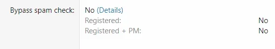

I'm at a loss then. The spammer account has the "bypass spam check" set to "no" and the content they posted is in the "spam phrases". I copied and pasted their exact message using a test account and that post did trigger the spam phrases.
Screen shot below of the spammers "analyze permissions" results.

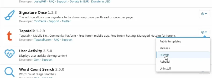

Do you have tapatalk's add-on installed? This often bypasses core XenForo functionality.
IF one allows registration through the TT app, yes. BUT if you use the force native registration option, no. And last I knew, in-app registration is default upon TT install.
Definitely needs checked out.
Good thought. I do have the Tapatalk addon installed, but I have "in-app registration" set to off.
Max, I appreciate the help. I made a few other changes and want to give them a chance to work before turning off Tapatalk. A lot of my members use it daily, so turning it off will be noticeable.
Totally understand. I've found over the years that TT users really hate having to use their browsers. And with a lot of them, losing it even for a short time will be problematic.
