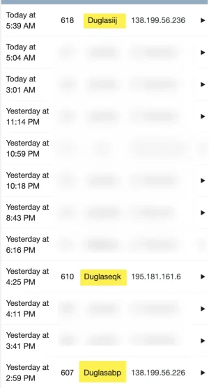

This bot is gently probing with at least a couple hours between tries to guess a users name. It's tried about a dozen times to login as Duglss*** Thing is, we do have a Duglas***. but he was banned for spamming in 2018. So even if they guess right they won't be able to post or change a profile.
Its not necessarily as much of a brute force attack on your server as some might think. A search engine query will tell them which sites any particular username is on.
