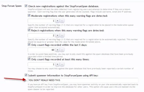

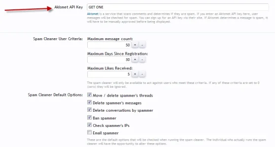

I have virtually no spam in my forums. Below is how I configure my spam management (Admin CP / Home / Options / Spam Management).
XF CapTcha is here: http://xenforo.com/community/resources/xf-qaptcha.1241/
For my sites (2) that allow unregistered guest posting, I also make this mod: http://xenforo.com/community/thread...flagged-as-spam-by-akismet.60157/#post-644504 (Without this mod, such spam is moderated but you might eventually find yourself deleting 10-20 such spams a day once the spammies find you. I have NEVER seen an Akismet-flagged post either in WP or XF that I wanted to keep.)
Indeed, use the proper settings and get the API keys. The reason to have the StopForumSpam key is to see stats of your submissions and/or to get in their list :) Also you can help other forum owners with your submissions who use StopForumSpam. So if you make a key, you help others. Without a key you can use it perfectly.
