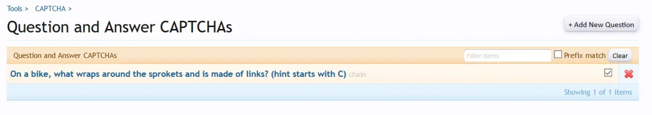

Hello,
I am trying to set up the Q&A CAPTCHA. I've added a question and answer. When I test adding a new user, I get the error below.
Please correct the following errors:
Some fields contained unexpected data. Please try again or contact the administrator.
I've tried disabling my other spam add-ons thinking it might be related to one of those. That didn't help.
The other CAPTCHA options allow new user signups without the error. They haven't been keeping the spammers out though.
Any idea what might be happening here?
Thanks!

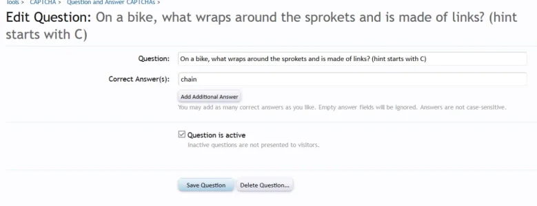

The issue is with the registration page, not the question and answer you have configured in the ACP.
Typically it's due to a customised/third party style/outdated template.
Have you tried removing the parentheses? Hint: starts with a C
Also "sprockets" is misspelled. :)
Thanks. Yeah, I did try it without the parentheses already, and thanks for the spelling heads up!
