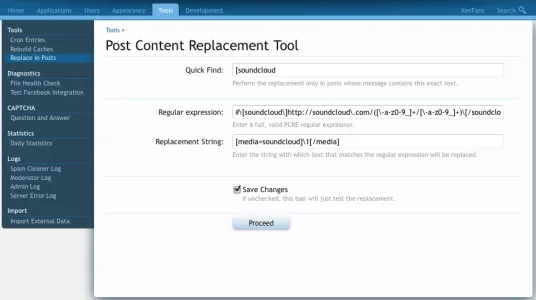

Here are instructions to convert your BB codes after the import:
1) Install this addon:
http://xenforo.com/community/threads/post-content-find-replace.6548/
2) Use these settings:
Quick Find: [soundcloud
Regular expression: #\[soundcloud\]http://soundcloud\.com/([\-a-z0-9_]+/[\-a-z0-9_]+)\[/soundcloud\]#siU
Replacement String: [media=soundcloud]\1[/media]
I tested it on my forum and it works.
