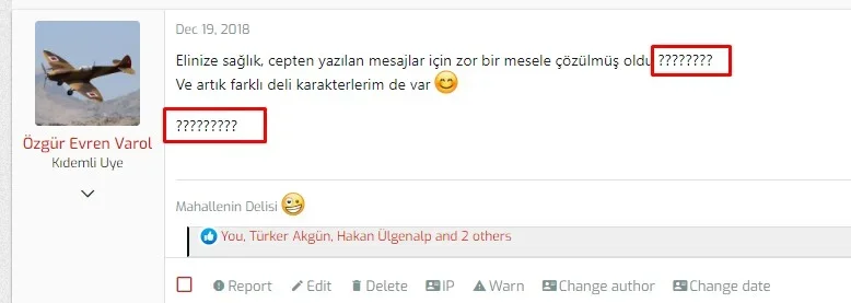

Example-2 : This post is also sent before upgrade, but emojiis in that post are not working ?
194888

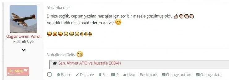

Befora UPGRADE it was like that
194889

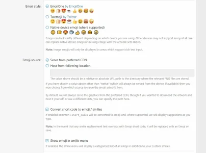

And this is how I set Emojis at AP
194890
