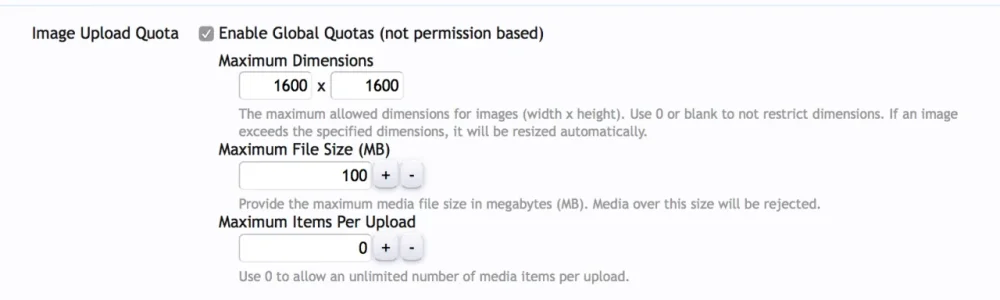

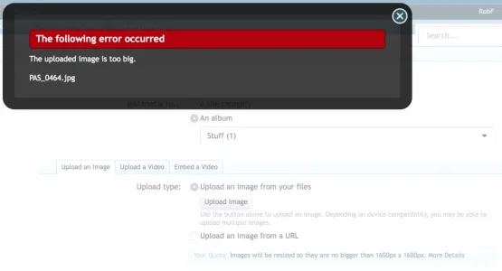

With XFMG it doesn't do the same. I've set the MB to 100MB and the pixel size to 1600x1600. But it still says the 6000x4000 pixel image that someone is trying to upload is too big. The only
Here's the error and settings. So for the moment global quotas are turned off. I tried doing it via user permissions but it doesn't make a difference it seems (might have to double check the Max File Size again...)
PHP max post and upload size is set to 32MB, memory set to 512MB and the file I'm trying to upload is 3M. It is however 6000x4000.

The same would happen if you attached it to a post. It's a subtly different error message but it tells me that it's too large to be resized.
There's an XF config option which controls this - limits things so only images below 20 megapixels can be resized. It can be increased:
PHP:
$config['maxImageResizePixelCount'] = 30000000;
That will allow images up to 30 megapixels in size to be resized.
