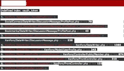

I'm currently running 2.2a. Yesterday when I was about to like a profile post I got this error:
I haven't seen it before. Everything has worked just fine. What's this error message telling me? How do I solve it?

This happens when I try to like another members profile post. Then after a few seconds this error pops up.
Ok, do you want to try the below file to see if it resolves the issue... Bookmarks is referenced in your error so maybe it's sort of a clash but I think this will resolve it:
Put this file in:
library/SocialConnect/DataWriter/DiscussionMessage
Thanks!
I will install this fix tonight when I get home. I will let you know result.
It seems to work fine now! Thanks! :) What was wrong? It's a little bit strange that I got this error all of a sudden since I haven't done any upgrades since the release if the new platform at the beginning of january.
You know what, I have no idea.
I couldn't even replicate it on my own board.
The underlying issue was a bit of dodgy code from me - but why it seemed to be fine until recently I'm not sure.

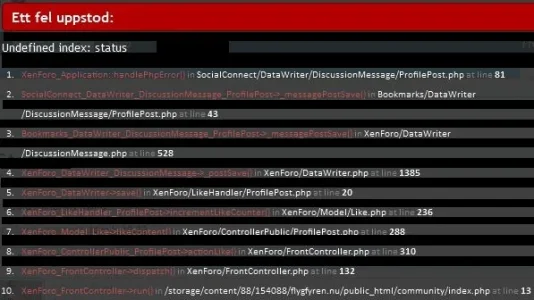

I found a new error. Last time I encountered it when I tried to like another members profile post. This time I got the following error when I tried to write a status update on the forum index page as well as my own member page:
Does the error go away after you go to the Social Connect page and then Unlink and then Link your Twitter account?
