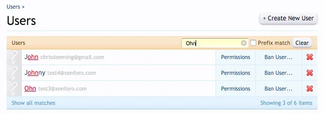

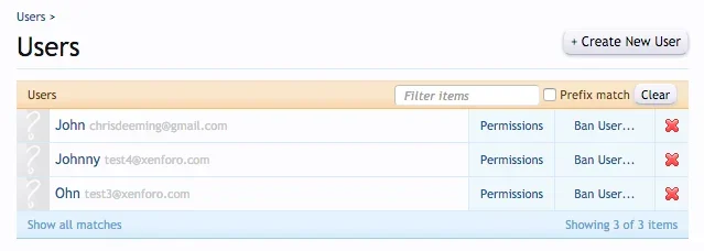

The way in your first post produces:
I think you're now doing this, with the filter:

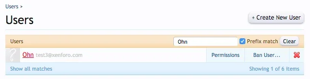

But if you just click "Prefix match" you get:
It simply means that what you're searching for must be prefixed with exactly what you have typed.
So if you had users John, Ohn, Ohn2, Ohn3 then all but John would be shown because all of the others are prefixed with "Ohn".

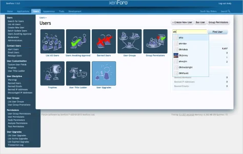

I suggest not using the "Search for Users" link, instead use the search box to the right as seen here:
The dropdown will work as you want with prefix priority and you can quickly find the exact member.
