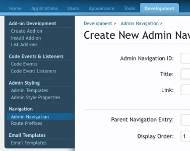

How do I make my own admin pages to control my addons. All of the custom features on my site have an admin page to approve, edit, remove, etc.
That is also part of creating an addon. It's under the Development tab in your Admin CP:
