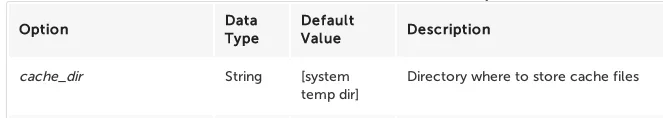

I would assume by the statement on the advanced options in the manual page that states
which stores cache data as files in the temporary directory of your server
that it places them in /tmp unless you tell it somewhere else. In fact, when you go to the Full List of File Cache Options on that page it tells you that by default it places them in the system temp directory which on a VPS/dedi will be in /tmp (again usually).

On a shared hosting - I'm not sure (I never used it much) but I'm sure that each shared hosting account has a /tmp directory for it also.
I would assume by the statement on the advanced options in the manual page that states that it places them in /tmp unless you tell it somewhere else. In fact, when you go to the Full List of File Cache Options on that page it tells you that by default it places them in the system temp directory which on a VPS/dedi will be in /tmp (again usually).
