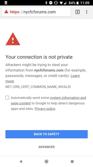

I posted about browsers suggesting to users that the site is unsafe before. I still get t from time to time.
Someone just sent me this today
Address nycfcforums.com
Is it due to being out of date?
Actually just realized after posting that he was accessing using https not http. So nothing to see here. Thanks.
Actually, there is still something to see here. Your site is not working. The https is not working. It's showing a certificate from Parallels Panel, valid from 11/18/13 to 11/18/14, which is why your users are getting the error.
Yep, if you aren't on SSL then you should be rewriting any inbound HTTPS connections to HTTP.
