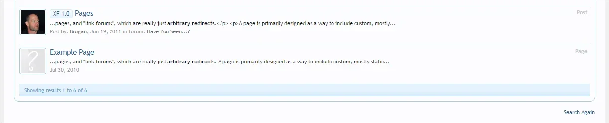

I just searched for 'arbitrary redirects' which is on the example page on this site and it fetched it OK.
